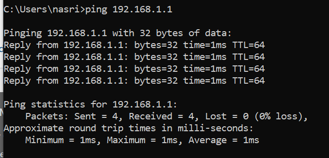

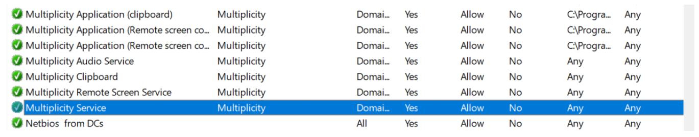

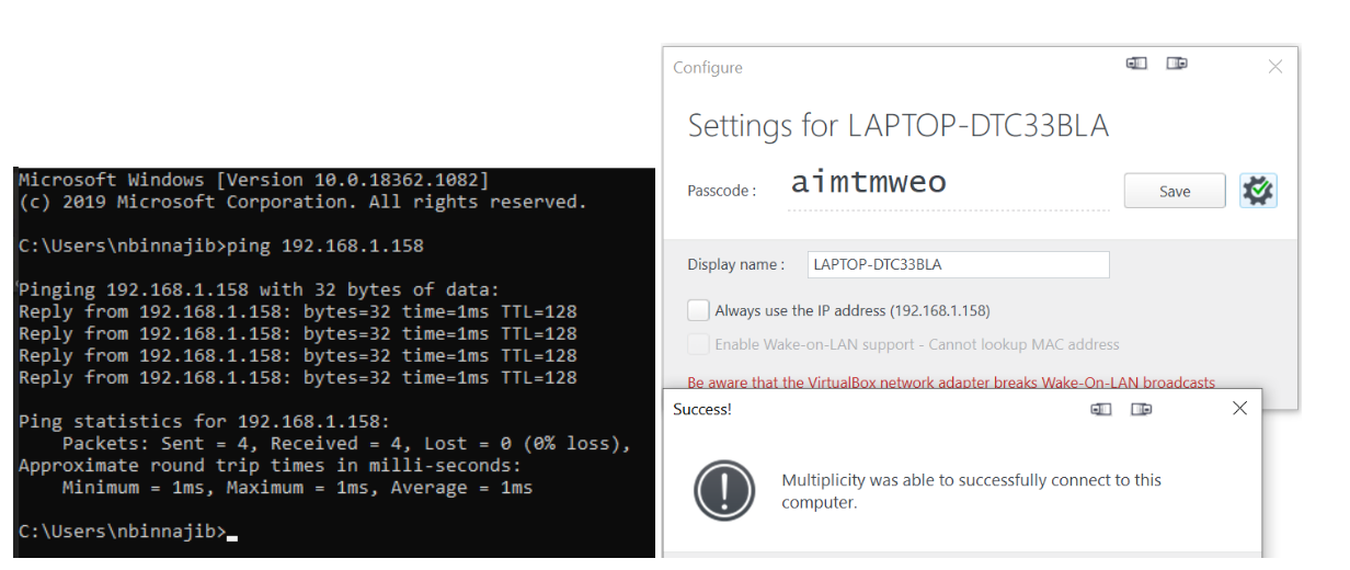

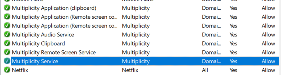

I have MP v3.5 build 00096.km on both laptop and troubleshooting to get the seamless to move from primary to secondary. I check that the ports are open and I can ping from both laptop. Also, MP indicates that it can connect. However, the mouse still cannot get from primary laptop to the other. Any advice?
Screenshots below for reference - this is from secondary laptop:
Results from the primary laptop:

Connections issues are not unique to this version thread, they are generic in nature.  If you still have an issue after reviewing this thread:
https://forums.stardock.com/486104/multiplicity-support-faq#connectionissues
Please create a new one here:
https://forums.stardock.com/forum/267
