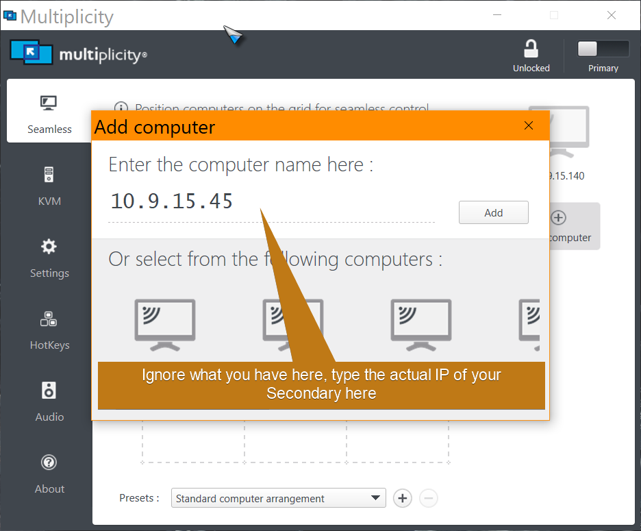

Private would have to do with what network type Windows thinks its connected to, not that they are member of the same 'WorkGroup'.  If you are certain that each network connection medium, on each, is set to 'Private' then you are good there.
On the Primary, in the connection window for adding a Secondary PC, if you add the Secondary by manually typing in it's stated IP (the one th Secondary says it has), does it work:
That worked.  And then when I went back to the name of the computer it is also now also working.   Not sure what happened but everything is working now.   I left it with the name in case DHCP assigns a new IP address.    Thanks
