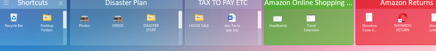

udated yesterday to new version - all fences are now much larger with HUGE text
I have been using fences 6 with no issue until I installed the new version yesterday. Since doing this all of my fences have become very deep with huge text size in titles

It is odd - all the fences on my main monitor are fine - all the ones on my dual monitor have expanded.
If I drag a fence to my large ( Higher Res ) monitor and back - it resizes them - so looks like this is resolution related

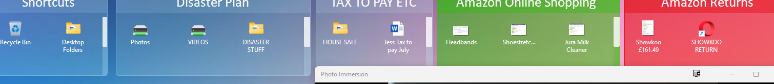

Spoke too soon - I just shut down and restarted - same problem again HUGE FENCES
I did as you suggested. Uninstalled. Shut PC. Reinstalled . Shut PC down - restarted - and all was OK
Now this again ?

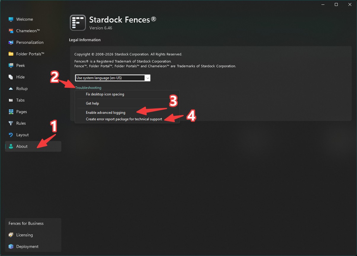

I get a request from Dev, would like to request you reinstall latest v6 and turn on Enable advance logging, once that is done, when the issue reappear, create error report package for technical Support. Send it in so Support and Dev team can review it. Refer screenshot below for steps.

Hi, please select "Enable Advanced Logging" from the menu / reboot, reproduce the issue and the team can have a look. The log upload does not have this enabled. Hopefully this log can give some information
