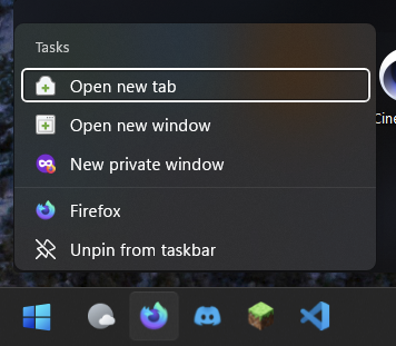

Without start11 enhancing the taskbar, if I change the default icon of an app, it shows it in the taskbar. When I enable start11, the custom icon is reverted back to it's original icon. So now the taskbar icons are default even when I have set custom ones.
This image shows the normal firefox in taskbar, but it is set as a blue icon

I disabled the taskbar enhancement and rebooted and the custom icons shows up for me. Maybe since I set it a while back the icon cache was refreshed or something
I unpinned the icon.
Opened the file location of the shortcut which was in start menu folder.
Changed the icon to the custom one.
Pinned it back to taskbar, which shows up correctly:
But whenever I open it, it reverts back to normal
This shows the blue icon correctly when start11 taskbar is disabled
