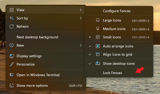

Sorry to hear you are having issues. Please check if you have not locked Fences. If it is lock please unlock it and try again.
Just as there is no "Customize Fences" option, no "Lock Fences" either.
Click the "Show more options"

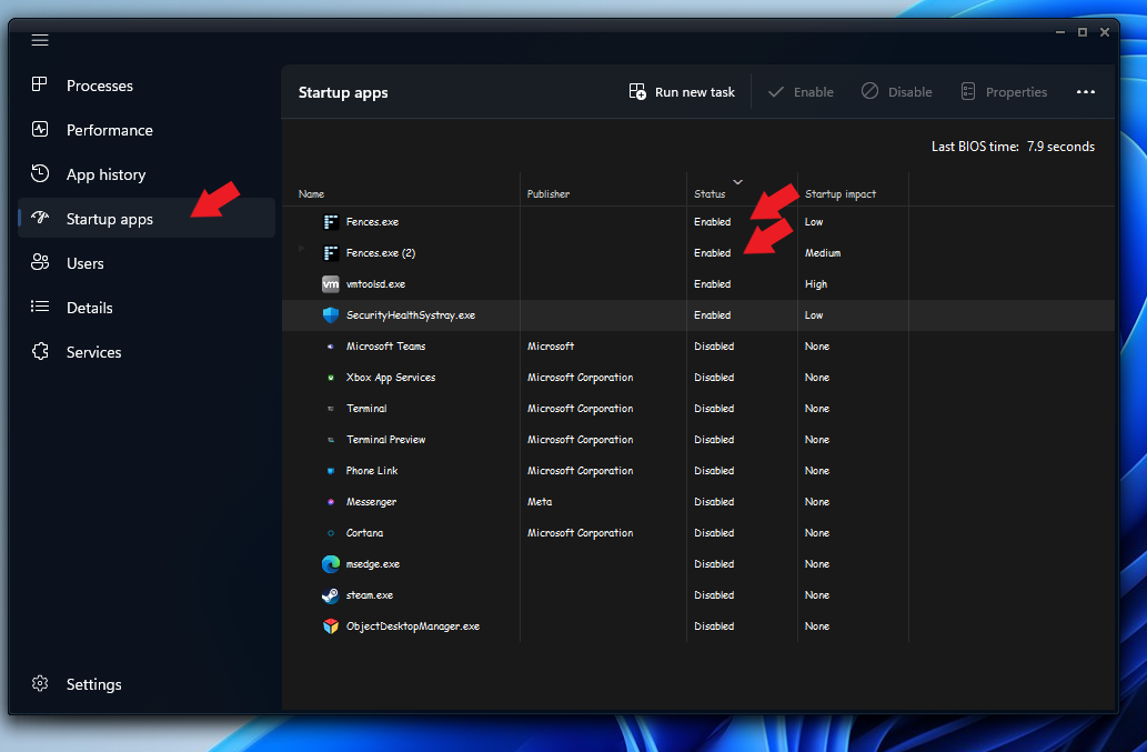

Please check your Taskbar Manager (right click on taskbar->Task manager-> Startup apps tab) and check if both Fences.exe status are enabled to start on Startup. If not please enable it and restart.
There is only one Fences.exe and it was in fact disabled. Enabled it, restarted but no change.

This time, the Configure Fences option does appear when i right-click, but still it does nothing. An the "Lock Fences" option is unticked.
I also have two Fences in my startup apps and they are both enabled. No change.
