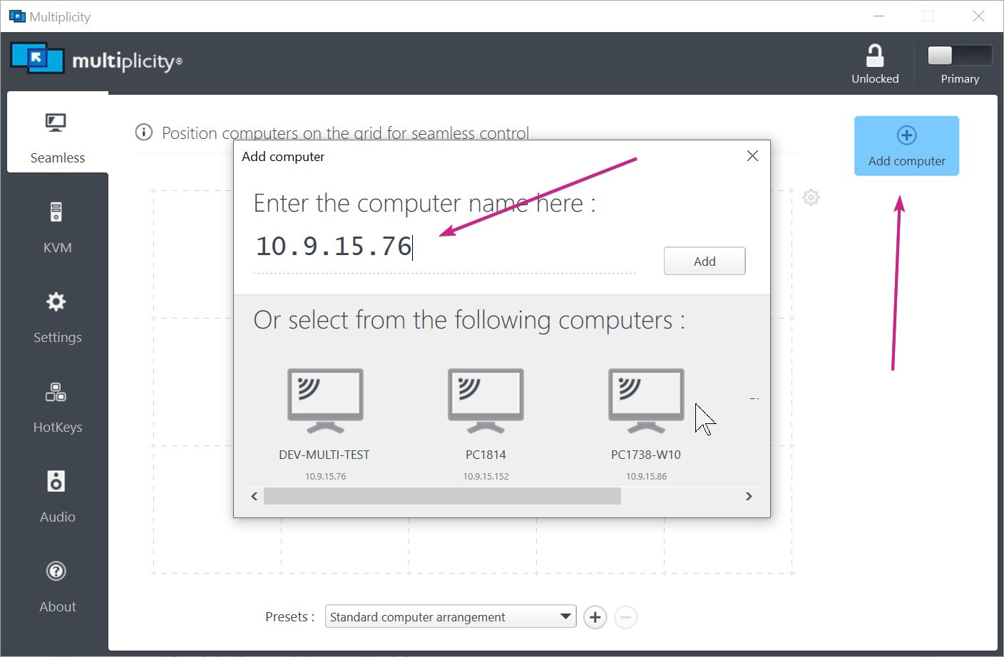

And try connecting to the Secondary by its IP (home one, not the VPN) instead of hostname:
