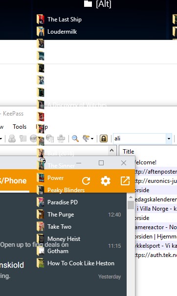

Fences partially overwrites windows on top of it
Has someone experienced, and fixed, the issue where one or more fences will overwrite the contents of windows above it? This happens at least once per day for me, but only with inactive windows/apps.

Video probably wouldn't give any more info than a picture. Besides, it's not something I can produce myself. It just "happens" and I've not found out what triggers it.
From the picture. That should not happened. As far as I know Fences only work on Desktop, never on top of any windows active or inactive. Please try the purge and reinstall problem to see if it help. : https://forums.stardock.com/486084/fences-support-faq#reinstalling

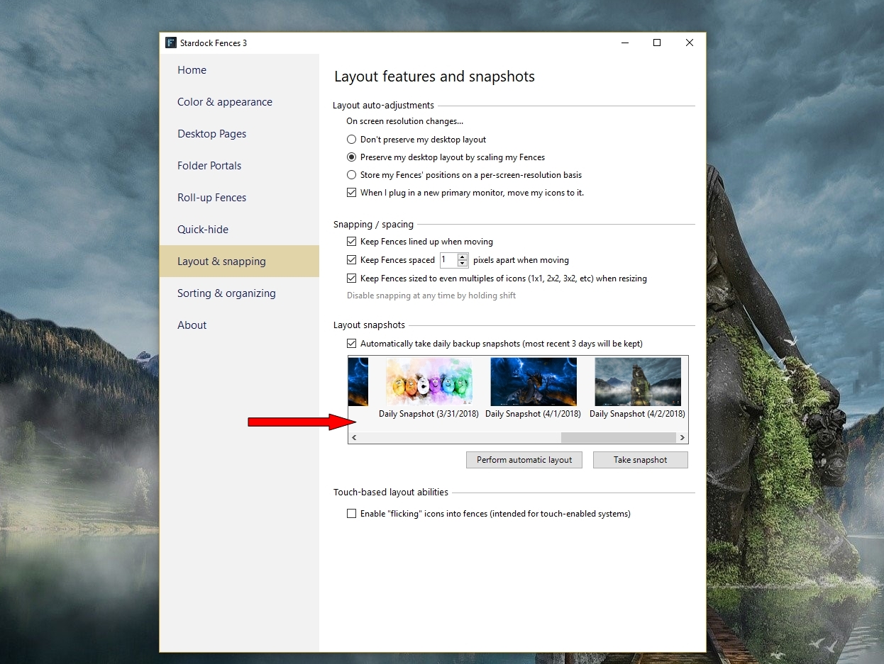

Is it possible to backup my settings, or should I wipe as much as possible?
Fences Snapshot will give you a backup of a setting you like
Well, it took a few hours, but it happened again. Seems to happen every time the folder is updated (these are folder portals) and the fence is refreshed while there are windows on top of it.

Windows explorer's not the problem. The drawing of the window is. If I minimze the windows on top and the restore them they will draw correctly. After a while, the fence will partially overwrite it again.

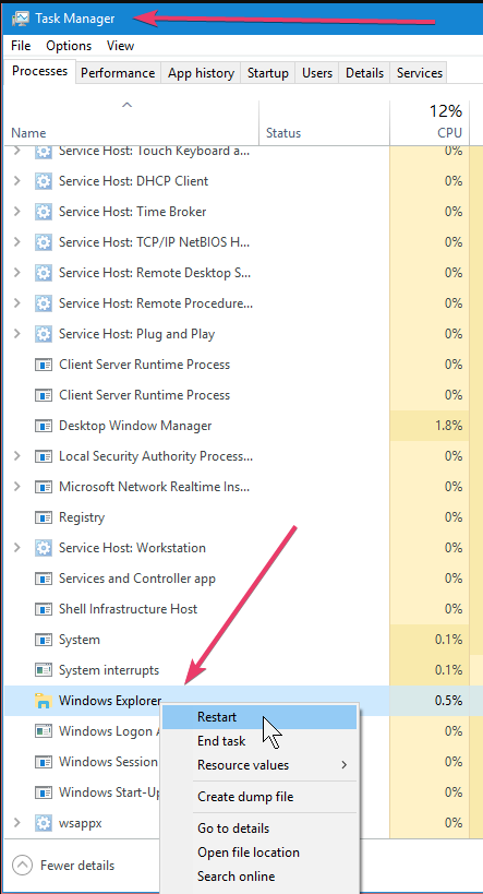

No... Restart Windows Explorere from Task Manager:
I want to know if that works....
