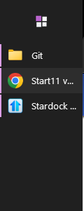

Issue 3: Start and app buttons only display visibly and in correct locations if 'task view' or 'search' is showing. Unticking Tasks and Search from appearing in the Windows Taskbar settings makes everything bunch up to the top so much the start button is obscured. All above screenshots are with 'Task view' enabled in windows taskbar settings, below is with this disabled:

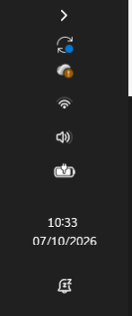

Issue 4: The vertical stack of system tray icons is highly inefficient, and the clock is slightly obscured:
Clearly some work is needed for your software developers with the latest windows versions.
