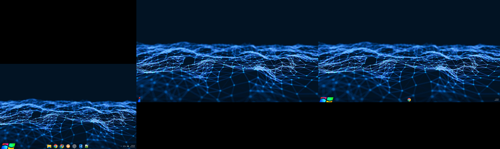

Trying to troubleshoot this issue on my middle monitor. It seems like the render area for the tray icons might be overlaying the render area for the start menu and clock. The issue sometimes moves back and forth between my second and third monitors.
Additionally, I'm wondering if it's possible to expand the area that fires the hover event that changes the start orb image. Currently it's only the original size of the stock windows orb, but my start button is larger. I can click the area outside the hoverable area and the start menu will appear. Note: while typing this paragraph I noticed it actually works as expected on my third monitor, but on my primary monitor it acts as I described here.

Thanks for your video. It look strange. Is there any different if you set the Start11 Start button Center? or Left Start button with all the Taskbar buttons also set to left? Just as a test to see if it make any different. Try those and report back.
Also, I believe the issue appear on specific monitor. Does those other monitors have the same issue? Also, need to know few things on your monitors.

This is a laptop (Lenovo x1 Carbon) with a docking station and two external monitors.
1. Laptop - 2880x1800 @ 175%
2 & 3. 3840x2160 @ 150%
The issue mainly happens on 2 but I've also caught it happening on 3 from time to time.

I'm assuming this is a multi-monitor, mixed DPI, mixed resolution test environment? I ask because I never see the issue if my laptop is the only screen in use.
Yes, it is on dual monitors system. The screenshot was from the primary monitor, but, I also don't see the issue on my secondary monitor. tested with 100% and 175% scale on both monitors or one at a time.
This could be a strictly triple monitor problem. If I duplicate the monitor two display onto three, or if I close my laptop lid so only monitors 2 and 3 are active, it displays correctly. I'll try your suggested clean boot as soon as time permits. Thanks.
I don't have triple monitors setup to test it. However, I have forward your issue to Stardock Support Team for their assistance. Please keep an eye on this thread for any updates. We appreciate your feedback and patience. Thank you.
