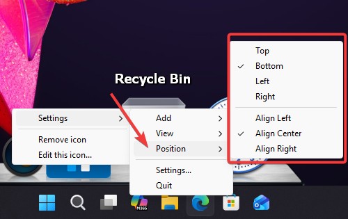

Sorry to hear you are having issues. Have you tried this setting? Right click on any empty area on your dock.
I do not have the pop up menus on my version which says it is 3.01 - says that it is up to date. I did figure out how to get it dragged again, However, locking the dock position does not work. Upon reboot, the dock slides over to the top left. It is quite annoying to have to move it out of my way. Why did this suddenly change as it always stayed where I placed it after reboot until recently. I do not even think I updated the OD app.
For tabbed Dock the position setting is on the ObjectDock Configuration Windows. Refer my screenshot below.
Also, have you tried "Lock dock position" after you have set your dock position?
