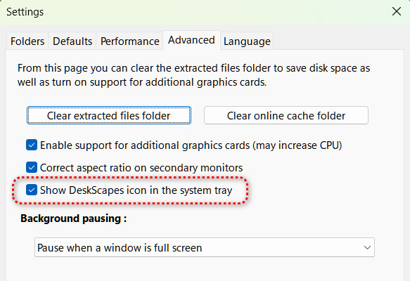

It is interesting though. After restarting explorer.exe and then right-clicking the desktop and selecting "Show more options," DeskScapes starts and the DeskScapes icon appears in the System tray. After restarting the computer, DeskScapes starts and the DeskScapes icon does not appear in the System tray even though " Show DeskScapes icon in the system tray" is checked.

We've had the system tray icon issue logged and that is expected to be resolved with a future update.
  • Internal Reference: ODNT-12317
