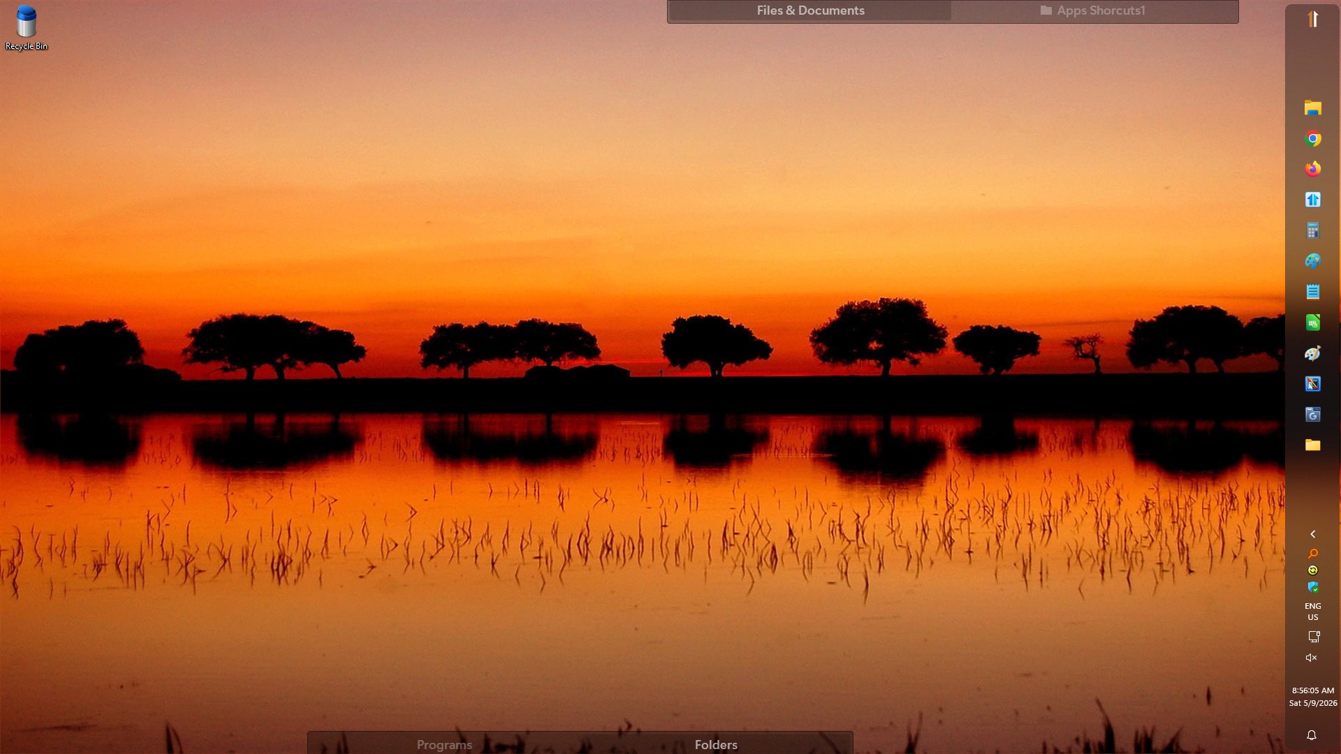

Sorry to hear you are having issues. I tested this one. And, I can reproduce this one. But, I finally can somehow "Fix" the tabs to stay at the bottom edge on my system. What I did to make it stick at the bottom are these steps.
  1. Move the Fences at the bottom edge of the screen. Check if it roll up and roll back down as you move your mouse in and out of the Fences title area.
  2. Do a layout backup.
  3. Rename it to something easy for you to identify it later.
  4. Reboot the system.
  5. If those bottom Fences still move up. Just do a layout restore using the one you just save.
  6. This should make your Fences back down to location you wish it for.
  7. On my system, once I done step 6 once. The location, stay at the bottom. It survive reboot.
Below screenshot was taken right after my Windows 11 system booted up.
