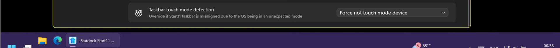

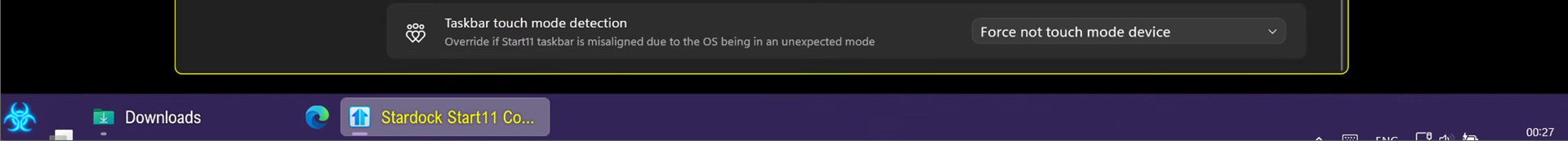

  2. When I use "Force not touch mode device", the windows builtin icons + time are all displayed at an offset towards the bottom and half visible.  Using "force touch" or automatic works fine.  Screenshot below.  I also tried resetting the settings, then just turn on the enhanced taskbar, and made the "not touch" settings and it's off (second screenshot).

The force touch mode option is only to be used if automatic does not correctly detect your device.
Given the behaviour, you have a touch device and it sounds like Start11 is working correctly so you should be leaving it on automatic.
If there is no Start11 shortcut then settings can be accessed by right clicking on the menu or taskbar (depending on settings). Start11 starts automatically so no link to start it is needed.
