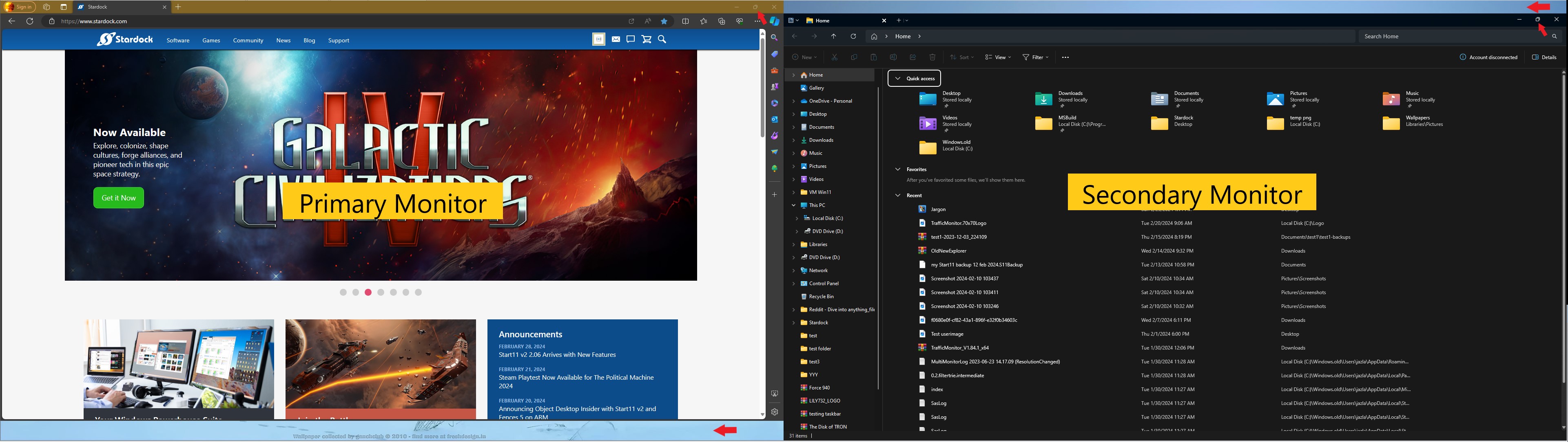

Howdy;
I just applied the 2.06 update and now my browsers/apps will not go to full screen. I have dual monitors.
TB set to auto-hide
TB set to top of monitor.
What's odd is on my primary monitor the gap is at the bottom while on the secondary monitor the gap is at the top.
I didn't apply any system/hardware updates prior to installing 2.06.
Any ideas?

Thanks for the reply. I did that earlier but was a nogo. If this is of any help; I did leave the settings the same but I moved the TB to the bottom of the monitors and can achieve full screen.

Something like screenshot below, yes?
Thanks Basj;
Yes, exactly like your screenshot. Display 1/Left; 32" monitor w/TB set to top, Display 2 = 27" monitor also w/TB set to top. Both autohide.
