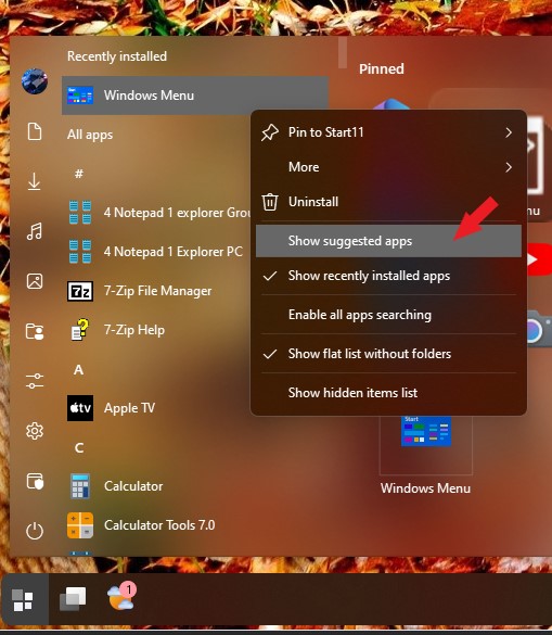

Disable suggested app list. Right click should bring up menu to un-tick that option.
Ah never thought to right click over there lol thanks.
