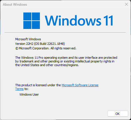

Reply #31 Top
Right clicking a preview window when multiple windows are open of an application and grouped together hides the menu behind the preview windows and makes it not selectable and usable. see attached gif image
[video]https://www.youtube.com/shorts/N3mL2FYA8iY[/video]
winver.Exe output
