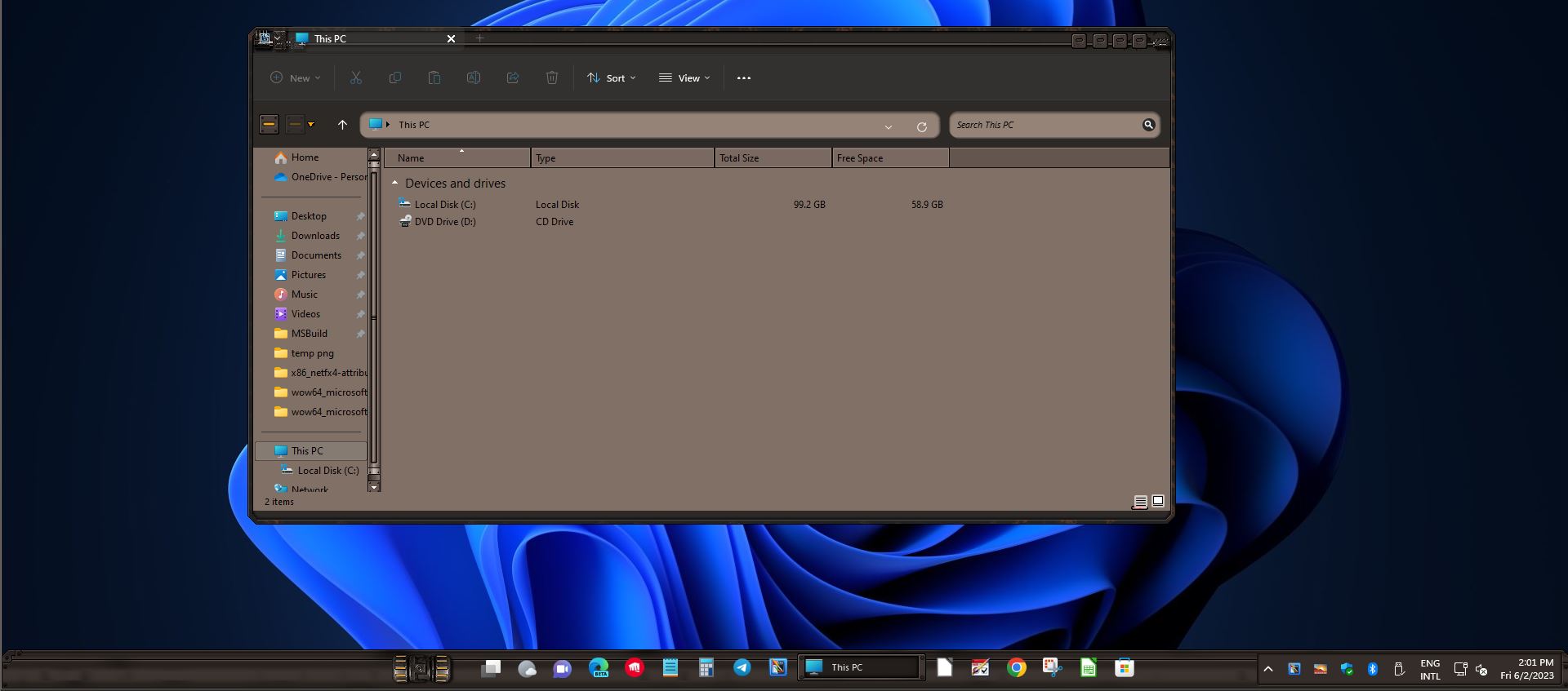

I did a short test with Force 940 and I don't see your issue on my Windows 11 system.
Quoting basj, reply 6
End of basj's quote
Interesting... the only thing I see different, is that your menu is still center-aligned, while mine is left-aligned... don't know if that makes any difference or not...
