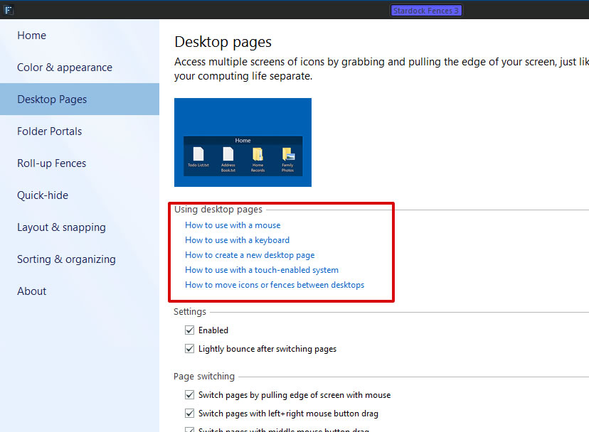

  1. For the Fence rollup issue. Try double click on the Fences titlebar. And see if it stop rolling up.
  2. For Fence disappearing. It might due to its move to a new Fences desktop page. You can try to learn how to navigate Fences desktop page or disable that function.

I found the Desktop Pages page and unchecked the "enabled" box but that did not fix the problem.
The material you provided starting under "Desktop Pages" above is cut off on the right and I don't understand what to do. It says "Access multiple screens of icons by grabbing and pulling the edge of your screen like................your computing life separate."

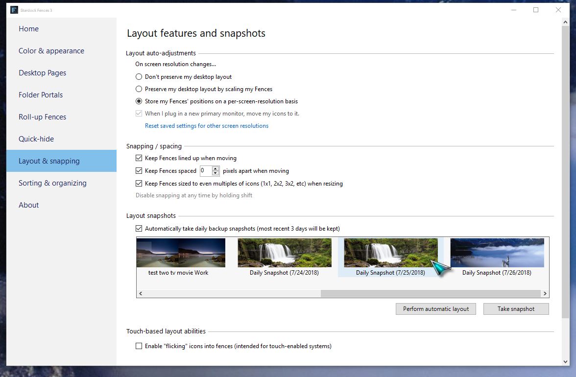

If you have disable desktop page and those missing Fences still do not reappear. Than there is something else. Have you tried restore layout snapshot? If not yet, please do. Fences have option to automatically save 3 days "daily snapshot" of your system. Try restore those earlier snapshot and see if those missing Fences restore.
I found the missing words on the Desktop Page page, but I still don.t understand what to do.
Do I have to re-enable Fences first? Then what? "Grab the edge of my screen" How, and do exactly what?

If that don't work. Try my other suggestion Reply#6. Try restore the snapshots saved from earlier day. 2 or 3 days ago.
I found that Layout page and I think that worked (even though the "Restore" button was not previously checked).
I guess I should leave that button on, correct?

Not sure on this one. Which button you was referring to? Please post a screenshot of this button.

Sorry, but that was the "Store" not the "Restore" button as shown highlighted in your page illustration above.

That "Store my Fences' position on a per-screen-resolution basis", I believe, is for system that running application that change screen resolution. For example old application/games that running in low resolution in full screen. If you don't run such application, you do not need to turn that on.

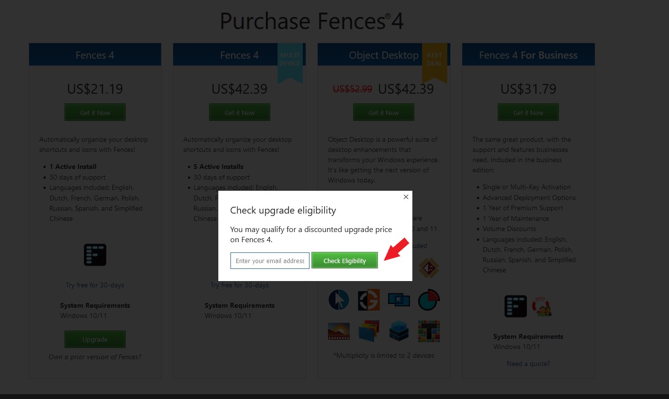

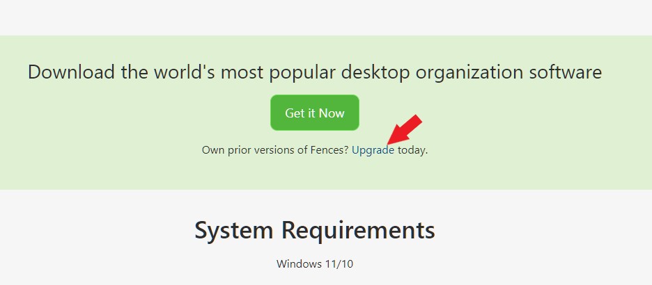

If you go to Fences 4 page: https://www.stardock.com/products/fences/. At the bottom of that page there is a link for Fences 3 user. Click that link.
When I looked at your illustration of the Layout page above I s[dotted the "Store" button checked and so I checked it on mine and it worked to bring back my missing Fence and missing icons. I did not focus on that next-to-last box "Layout Snapshot" which I did not check before but when I checked it just now it was checked. So< I have no idea how it fixed itself.

The link to that upgrade did not work.
I opened it but the link to upgrade did not function.
I also copied the web address and searched, but it opened to the same page that had a link that did not work.
Please try different browser or different system. When I click that link it open up a new page: https://www.stardock.com/products/fences/download
and if you click on "upgrade" you will get something like screenshot below. You just need to enter your email address that linked to your Fences 3 in there.
