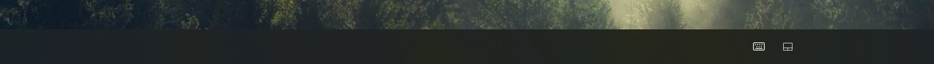

Uninstalled start11 and this happened. Icons misaligned. I will have to reinstall it then get it back to the usual normal taskbar to realign the icons. Stardock should have more programming power to avoid these kind of issues especially before releasing programs to the mass especially if it costs. For now I reinstalled fences3 and will see if the explorer issue will come back or not. Then if it will not get resolved possibly I will get a refund ticket. Also it is interesting that on a AMD R9 with dGPU 3050 ti still fences stutters a bit while it is being dragged. Definitely much slower when dragged compared to a normal window while it is being dragged. These things ruin a lot of the experience.
