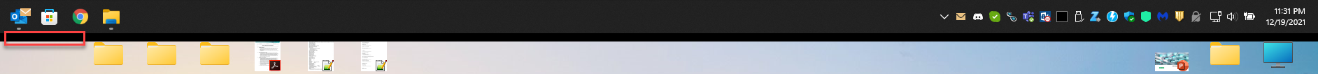

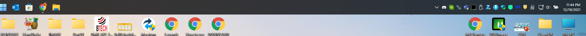

There is a strange and very annoying issue with Start11 and Windows 11.  This issue did not occur with Start11 and Windows 10.  It also does not occur if I uninstall Start11. The issue is, very frequently all of the icons on the desktop shift up by a few pixels causing them to all rearrange.  There is also and area below (I have the task bar on the top) below the task bar that does not get repainted and just leaves trails behind what ever passes it (mouse pointer, windows etc.).
Here is a screenshot of before (normal):
Here is the after:
You can see the icons shifted up and I highlighted the black bar that does not get repainted (taking the screenshot clears the trails left behind).  The only way to fix this is to kill explorer and restart it.  But it will just come back again.  Very frustrating.
