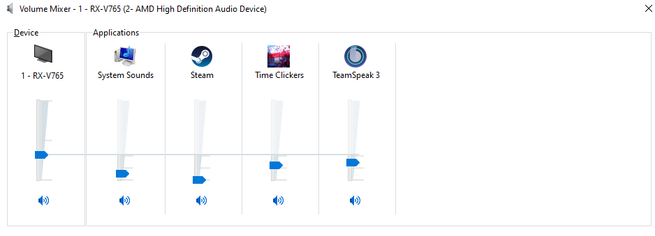

Try unmuting the sender:

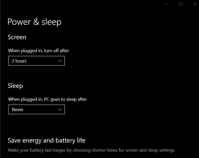

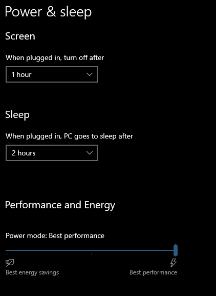

As a test, if you are 'sleeping' the PCs, try having both stay awake but just powering off the monitors:
Neither of my machines sleep despite the sleep settings. they stay on 24x7
Primary
Secondary
wut do?
I applied the settings for no sleep ever. things improved on log on. screens blared the log on screen all night. is this power efficient and is this the default stardock stance?

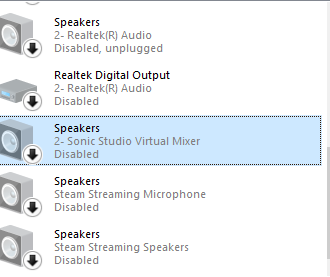

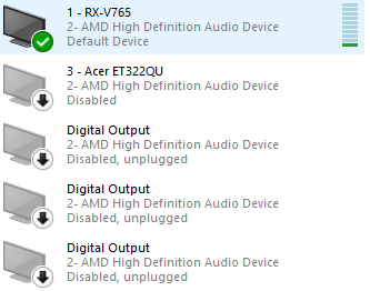

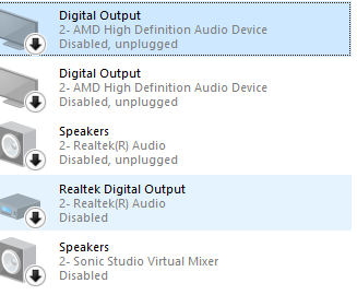

For reference I've killed every single audio device available other than the expected device.
