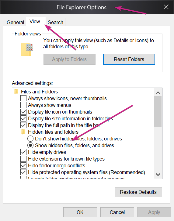

Do you have a License.sig file here:
C:\ProgramData\Stardock\Fences3
Not that is ProgramData, not Program Files(x86).  If you dont see ProgamData, enable the viewing of hidden files:
