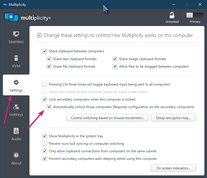

While using both machines (primary & secondary), Multiplicity seems to work just fine - great, actually.  However when I am then done working and want to put both active computers asleep, the secondary does not go to sleep.  I have unchecked the seemingly relevant setting "Prevent secondary computers auto sleeping whilst using this computer."

There is nothing in MP that will force a Secondary to 'sleep' - there is to 'lock' it:
There may indeed be an issue (and logged in the past) with the 'Prevent secondary computers auto sleep...' option.  It is being looked at.
Internal ref: Mantis: 0206824

I'm not sure but maybe changing the lock function to be independent will allow the secondary to sleep if I don't use it for a while?
