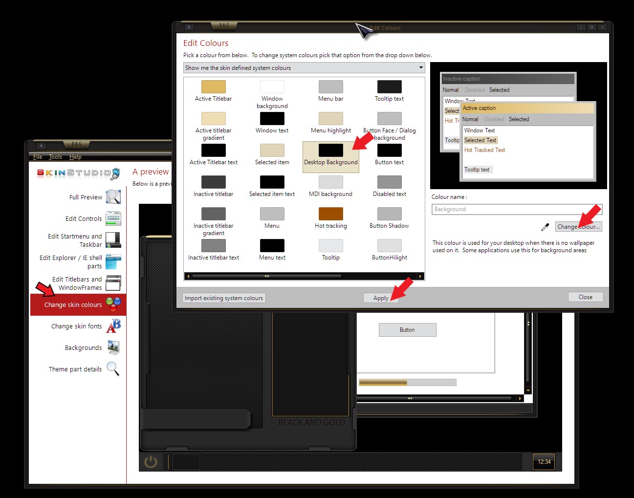

You should be able to change that using the Desktop background color via skinstudio-> Change Skin colors-Show me the skin degined system colors(drop down menu)-> Change "Desktop background" , refer to below image.

Thanks.. and have you tried the solution I mentioned above?

If your Windowblinds run with no issue, you should not need to reboot. Just apply the changed skin within Skinstudio. If you set the desktop to use just color as wallpaper it should be immediately apply.

The background color was successfully changed from grey to black in SkinStudio and was effective immediately. What I am testing is whether this change survives a monitor powerup after the monitors are shut down after 30 min inactivity.
When the skin background was grey it would overwrite the Windows background color (black) on monitor powerup so I was constantly resetting the background to black. This behavior should stop now that the skin background is set to black.
