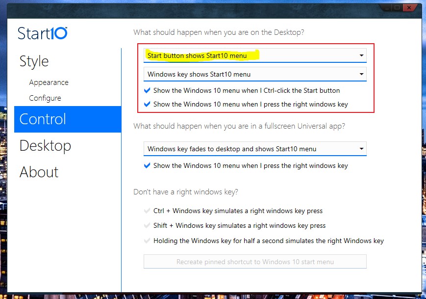

If you have Start10 configured like this it should work:

Sorry to hear you are having issues. Could you check if you setting are set as below
Please check that and let us know.
+2 Loading…
Thanks very much basj. It works now.
