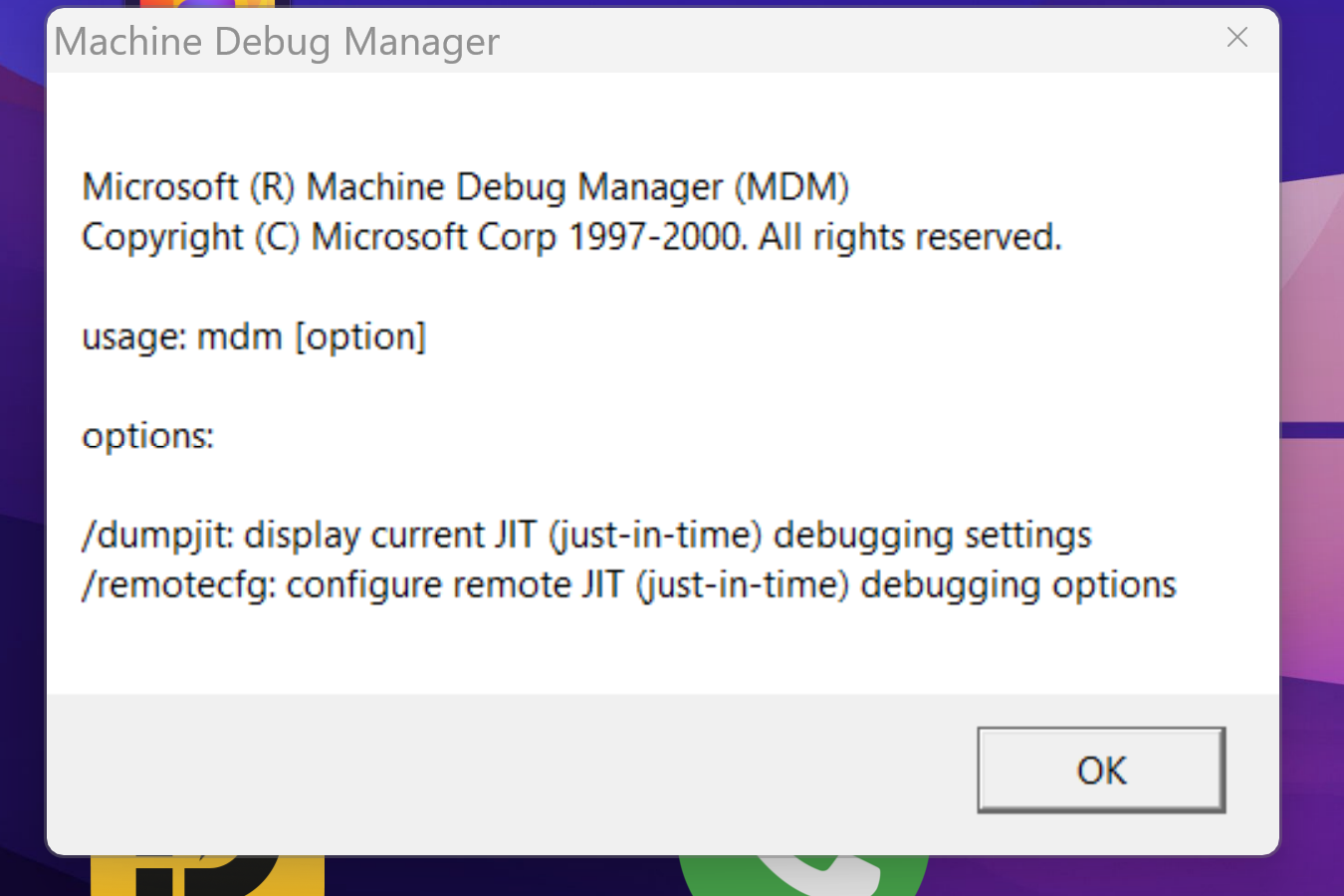

Cannt install Start11 2.72 on HP Tablet
Dear Stardock Support
I have Start11 2.72 (licensed) installed successfully on my desktop PC but cannot install it on my HP Elite 2 G8 tablet. Microsoft Debug manager pops up (see photo).  I've never seen this before when installing any software.
Both machines are running 25H2 (OS Build 26200.8524) and both have MDM installed.     I tried end Task from Task Manager but this didn't help. Can you please advise?

For further insight, I can tell you the Microsoft Debug Manager prompt usually means something in the installer process crashed and Windows is offering to debug it.  It is not normally the cause by itself.
You can:
1. Check the exact Start11 installer file version you are running (right click Start11v2_Setup.exe -> Properties -> Details tab).  I would expect it's the same file version that worked on your Desktop.
2. On your tablet, you can also check Event Viewer under Windows Logs -> Application for any error at the same time the install fails. The faulting application details from that event could help to narrow down the cause.

No, my tablet is running the normal stable public release of 25H2 and the same Start11 installer version is used. I do have a third machine running the latest Insider Preview build and Start11 installed on that with no issue.
