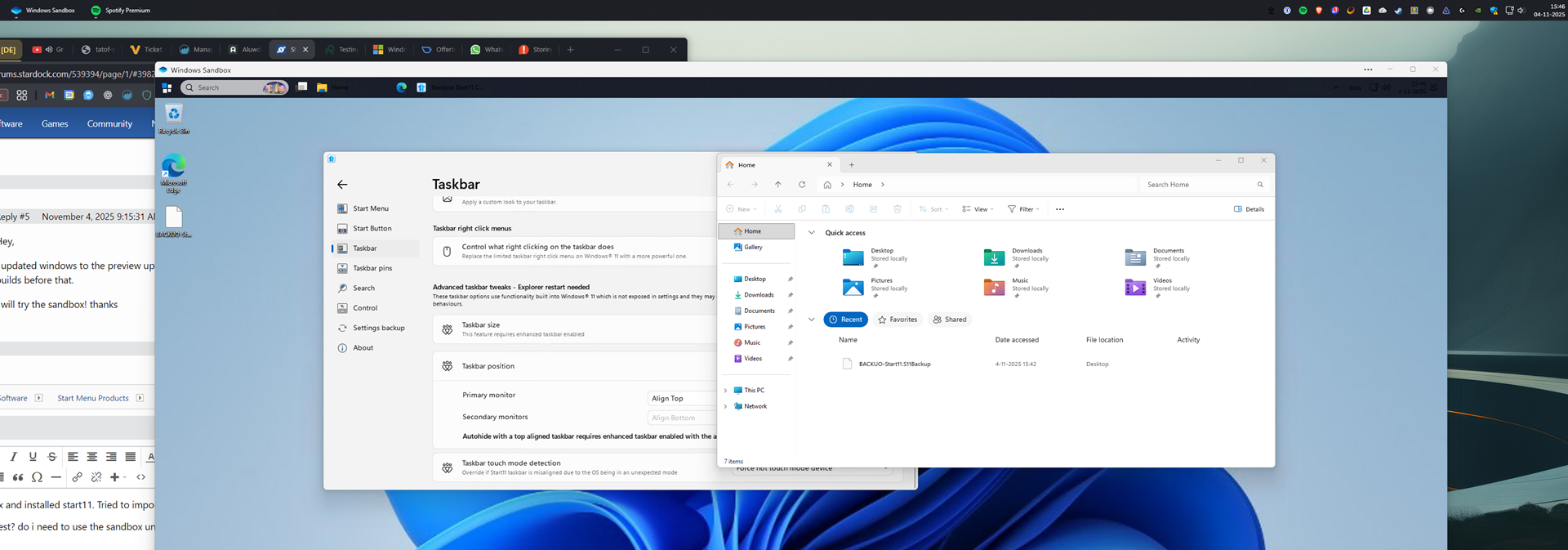

Oke i am in sandbox and installed start11. Tried to import the backup but doesnt work great.. looks awefull 😅
Anyhow, how do i test? do i need to use the sandbox untill it crashes?
Yes, you mentioned that it crashed every +/- 5 minutes,yes? Perhaps just see if it crashes around 10-15 minutes etc.
ah no, works fine on a clean sandbox install. (didnt try for 15 min with al the same windows etc, because of the clean install)
