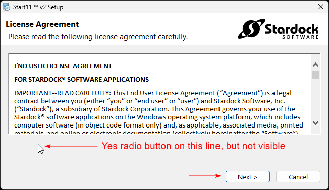

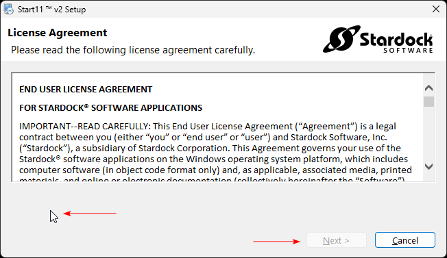

As seen in the screenshot, the Next button will not enable, and I cannot install the application. The same problem with the Start11 v2 version 2.56 beta, which I downloaded from my account page.

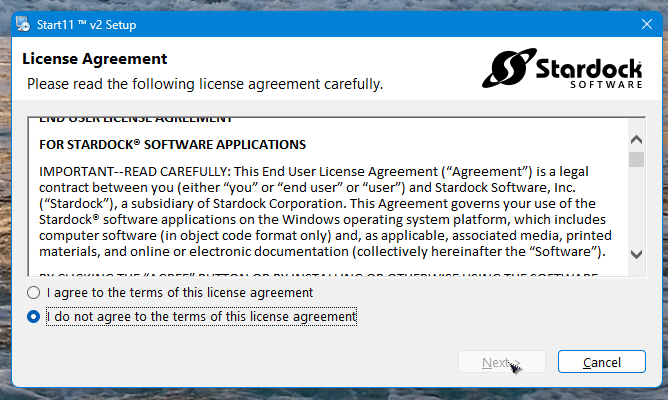

Sorry to hear you are having issues. Not really sure why you have missing part in that License Agreement popup Windows. What you should see is something like my screenshot below. And that "Next" button only clickable once you click on "I agree to the terms..." radio button.

By the public website, I meant this page where anyone can access and download the trial installer, https://www.stardock.com/products/start11/
The workaround with the tab key doesn't work. Restarting the computer and running the installer as Administrator do not work too.
But I have found another way to make the Next button enabled. The two radio buttons were actually there but invisible. Tab key did not focus on them or make them visible. But I could click on the invisible line of the Yes radio button to select it and have the Next button enabled.
When I clicked the line below it, which should have displayed the No radio button, then the Next button was disabled again.

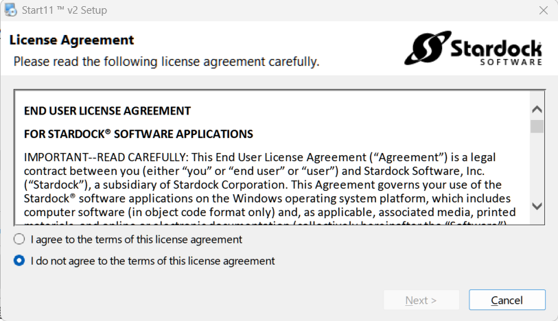

This is what comes up for me, and as I said the tab does nothing in this dialog.

I did notice when installing 2.5.6.3, that the Tab key does move the focus from "Next" to "Cancel."
