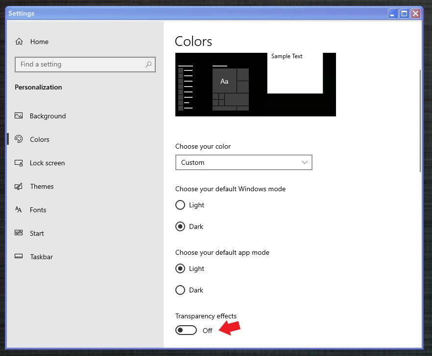

Most probably its conflict with other settings or other applications. BTW, have you try turning this setting off?
