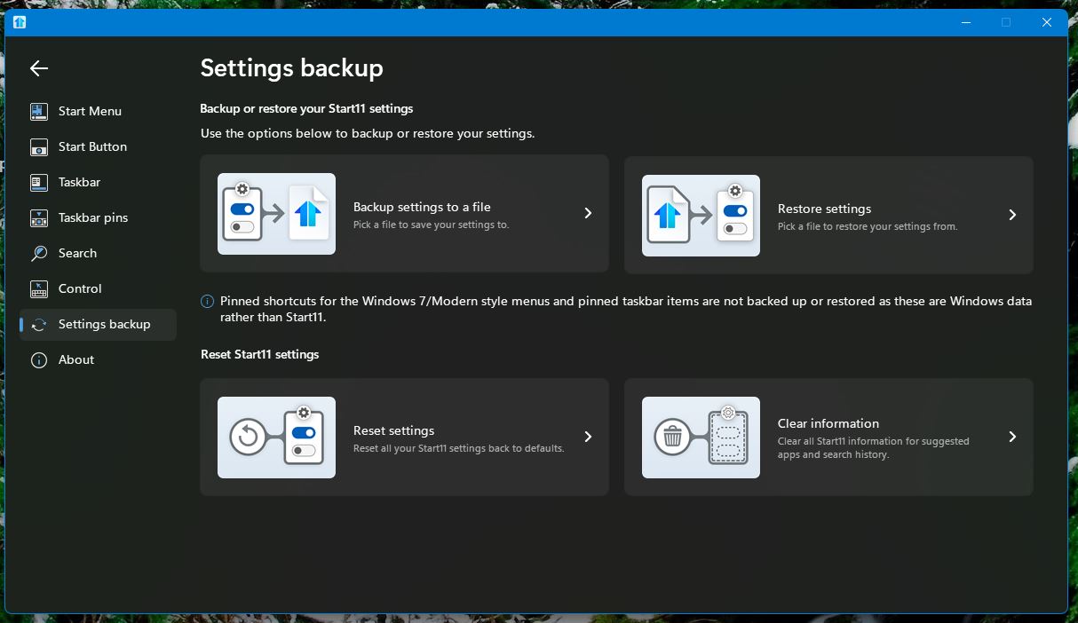

You should be able to to install V3 over V2. It worked fine for me. Also Start11 uses the registry to store its information. Unless you uninstall and tick off the remove settings option they should remain. If you're worried about a mishap then you can always export your settings from V2 and import them back in V3 (should you need to).

For your question. I believe your V2 version setting will still be there once you update it to latest V2 updates. Just to be sure, you can always back up your setting using its build in backup functions, before you do the updates.
Basj.  The upgrade worked well.  I was confused because this version required a repayment. But it overlaid the original 11.
I also learned how to back up the setting from a registry export.  Thanks to all.
