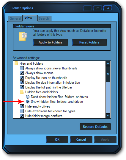

Open "Folder Options" and enable "Show hidden files, folders and drives"
Then go here: C:\Users\YOURUSERNAME\AppData\Roaming\Microsoft\Internet Explorer\Quick Launch\User Pinned\TaskBar
Look for the shortcut(s) that does not belong there and delete it/them.
Remember to disable "Show hidden files, folders and drives" after you're done.
This is the solution for Windows 10, but I think the same applies to Windows 11.
