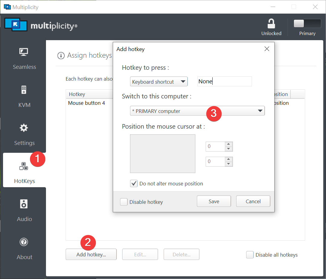

I suspect you mean 'stuck on a monitor of the 2nd PC', yes? If you set a hotkey to have the cursor return to the Primary:
Does that restore normal use?
