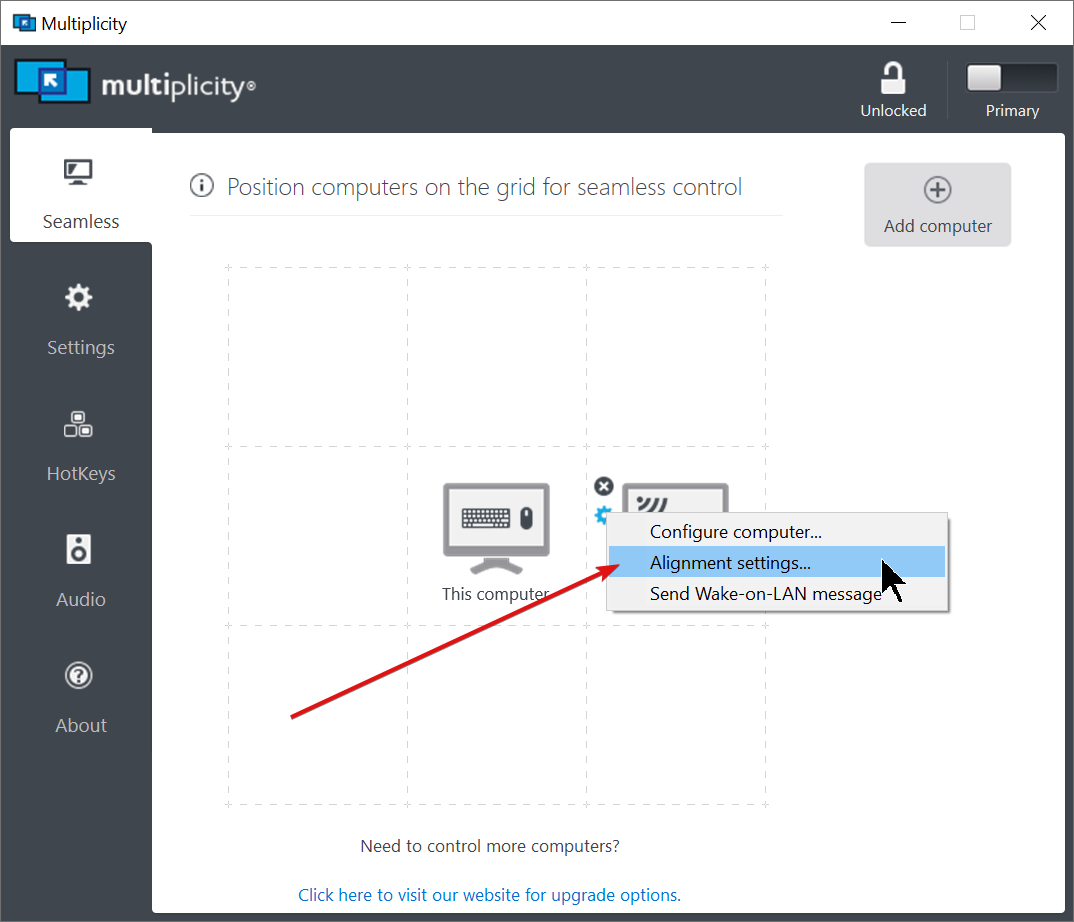

That means someone in your environment changed (3rd party app, setting, Windows itself).
While editing this is my 1st instinct:
It could be that you would need to do a clean boot (on the Secondary) to see if indeed its something else:
https://forums.stardock.com/486104/multiplicity-support-faq#cleanboot

So something other than MP did change, Donkusai.
Did you work with any of the other suggestions I had posted?
