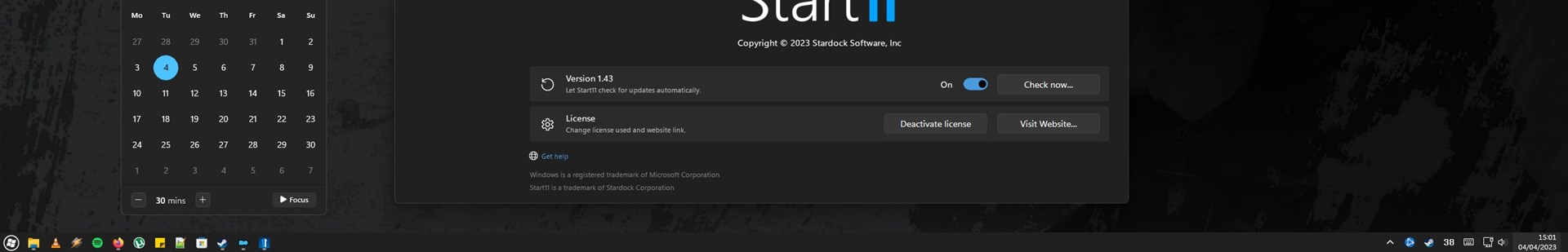

Im currently on windows version 22621.1485.
Every since windows updated the taskbar on windows 11, ive had this issue with the notification panel appearing on the left of the screen rather than above the date/time on the right of the screen. This issue has been persistant throught start11 version 1.41, 1.42beta, 1.43beta and it still exists in the full version 1.43. It only occurs when the enhanced taskbar is enabled in the start11 options. I need to use enhanced taskbar to be able to make my taskbar small otherwise this wouldnt be a problem for me.
I have done a fresh install of windows 11 and the problem still exists. I have done a fresh install of start11 and the problem still exists.
When i raised the issue on the 1.42beta forum i was told it wasnt anything to do with start11. When i raised the issue again on the 1.43beta forum i was told it was fixed for the majority of people. At first, when i installed 1.43beta it didnt happen or atleast it felt liek it didnt, but the issue is still there. Hoping it will be fixed.
