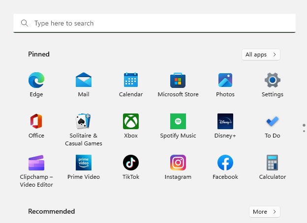

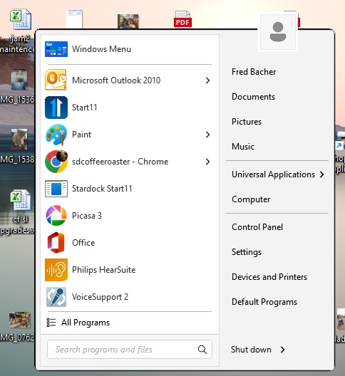

Thanks.  I think I did two posts of this same issue, sorry.  win 11, home edition, 22h2, build 22621.963.  I opted for the center orientation of the start menu on the task bar (traditional win 7 start menu) and that seems to be what makes the start menu screw up and revert to the search menu.  I put the start menu over to the left side orientation and so far it has not messed up once.   The first image is what I expect when I select "start" and the 2nd is what will suddenly pop up instead of the right start menu.  Nothing corrects this except for a log out or reboot.  But selecting the left orientation seems to NOT yield this error.  Hope this helps you find out what's going on.  Thanks.
That look like the default Windows 11 Startpanel. Need to know few things.

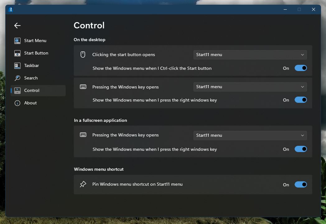

  2. What is your setting on this page on Start11.
