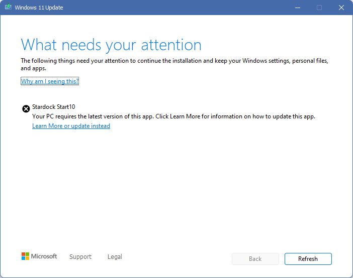

I am running Win11 22H1. Windows update says 22H2 is available, downloads okay but when about 35% installed it halts with an error saying I must update Start10. Ony thing is, I am running Start11, beta 1.27.
9,647 views 24 replies
Same here, I had Start11 1.25 installed, got the same error while installing 22H2, cancelled it, uninstalled Start11, reboot but got same "update Start10" error although no Start1* SOftware is installed anymore

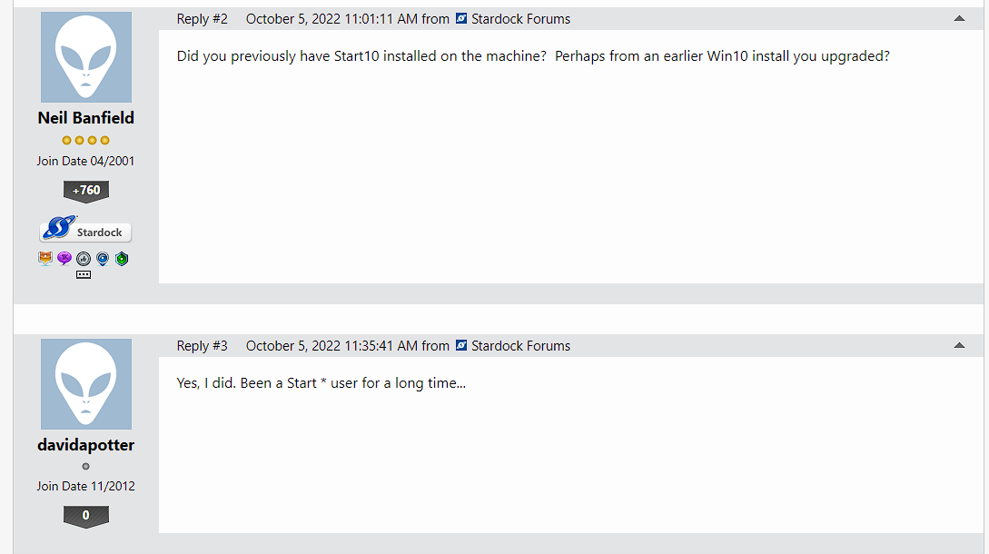

Did you previously have Start10 installed on the machine?  Perhaps from an earlier Win10 install you upgraded?

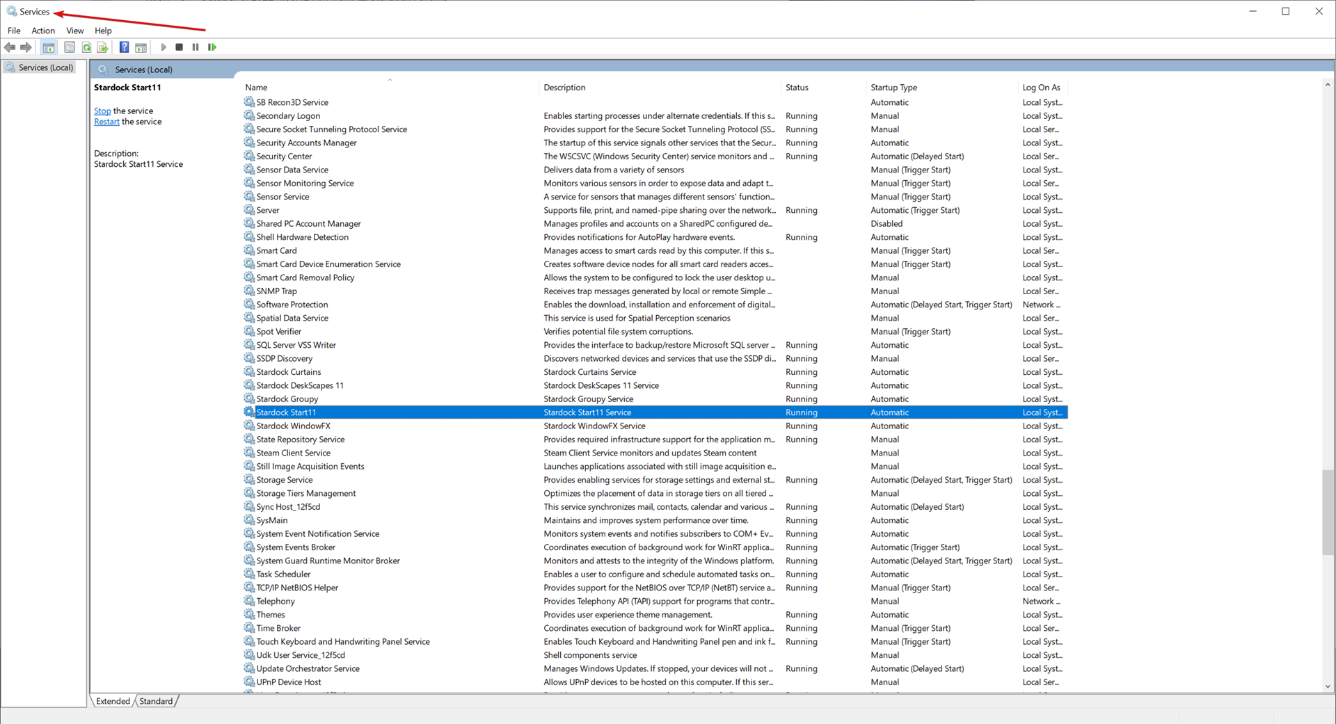

In Services on that PC, what does it have for Start, 11 or 10?
Regardless, if you set the service to 'Manual', reboot, then try to install the update, does it work then?
If so, and you re-enable the service (Auto), reboot, does everything work?
No, it doesn't. I set the Start11 service to Manual, stopped it, and rebooted. Checked and confirmed that it was not running. Tried the update again -- still didn't work...

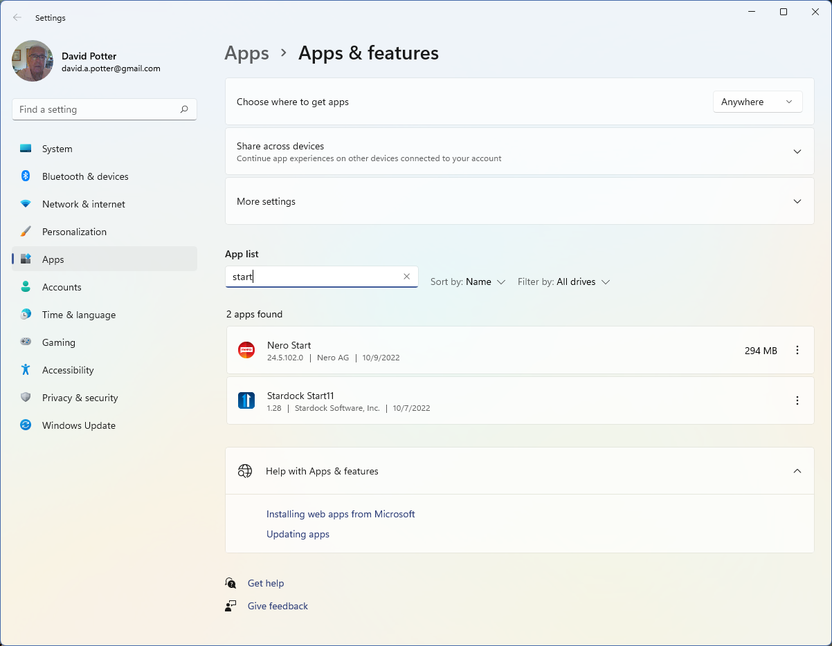

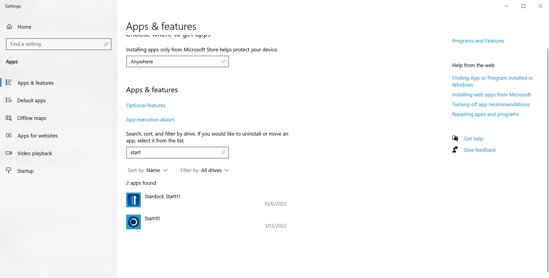

When you search Add \ Remove, do you have two instances of Start, 10 and 11 or one or the other (what one if so)? Example:
Also, did you once have Start10 installed via Steam?
Just one -- Start11. Also, no, I never had Steam -- All installations from Win10 (old computer) or Win11 (new one). Installed Beta 1.28 via download from Stardock...

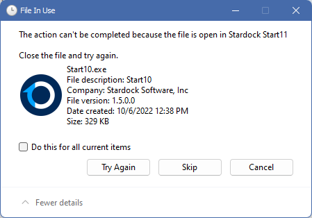

I will try and try again. Just found several start10 directories and files, even though it doesn't show up as an existing app... So I have been trying to delete them all (brute force, hit it with a hammer approach) and things got interesting -- look at this:
Why is Start10.exe open in Start11?  Anyway I am going to keep trying -- will let you know -- and thanks very very much for your support...

Please do not delete that file as that is part of Start11 which is why that file is locked from deletion.  It is there for legacy support of older shortcuts.  It is not why Windows is detecting Start10.

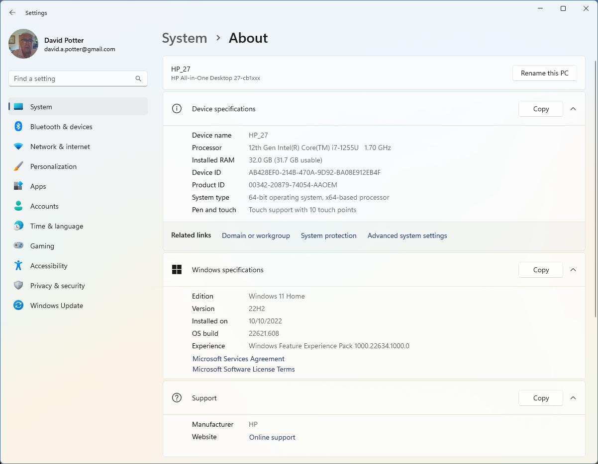

OOkay, up and running with 22H2 and Start11 1.28. deleted everything having to do with Start10 before I saw your message. Windows update then worked with no problem. Restarted, restarted service, set to automatic, and to be on the safe side I reinstalled 1.28... So far as I can tell it's all working fine. Thanks again!
One year after this topic, I'm still in the same situation : impossible to update Windows to 22H2. I have tried everything that was writtent here and it continues to detect a Startdock10 issue (see Reply10 above). What I gave tried so far :
- uninstall/reinstall startdock 11
- be sure I have the last version of Startdock11
- clean the registry manually for everything related to Startdock10
- try to install Windows update when Startdock was totally uninstalled and registry cleaned
- made a research on "Start10Config.exe" and "Start11Config.exe" : doesn't find anything.
I don't know what I still can try.... :/
