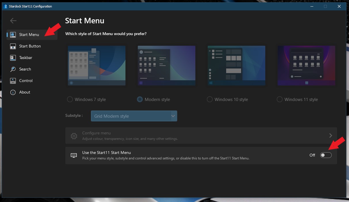

Hi Basj, thanks for the suggestion.  When I initiate the Uninstaller I get a message that tells me to turn off Start11 if it is running.  I'm not sure what this means as there is nowhere in particular that turns off Start11 in the Stardock Start11 Configuration app.  There are a lot of On/Off dialogues for the Start Menu, Button, Taskbar, etc.  Am I to toggle each of these off before uninstalling?  Should I also reposition the Taskbar to the bottom?
You can stop its process in Taskmanager and or try disable Start11 here :
