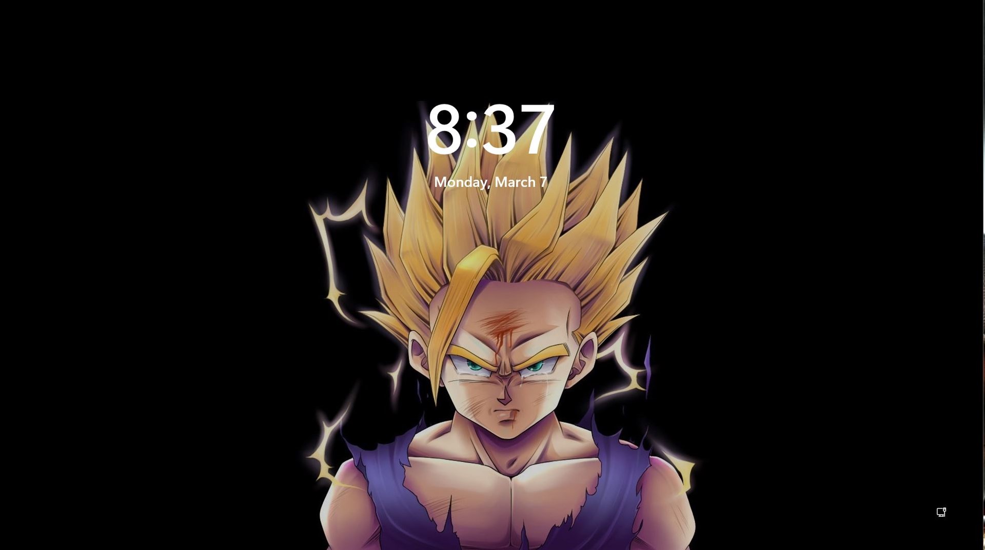

Sorry to hear you are having issues. But, I changed my lock screen using this steps : https://www.thewindowsclub.com/how-to-customize-windows-11-lock-screen. And my lock screen is change. BTW, I also have Start11 installed and running on this system.
