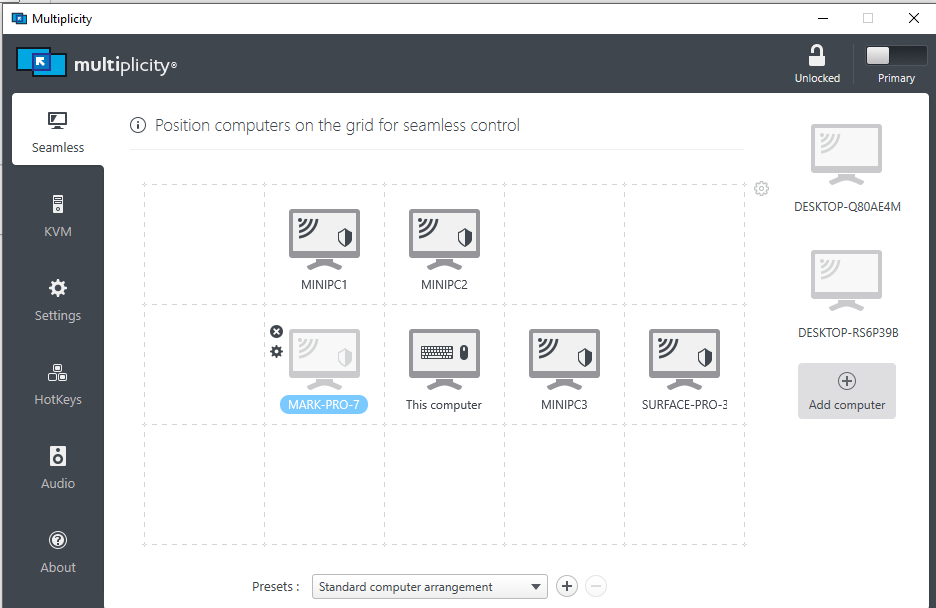

My problem:
about 1/3 of the times I start my machines multiplicity will fail to recognize and connect to the surface pro 7. That machine will remain greyed out on the dashboard. Restarts don't seem to affect it, but leaving the machines running for 30 to 40 minutes usually rectifies the problem (not always). This is a problem that hasn't always been an issue.... this combination of machines worked flawlessly for months then began to pop up about a month ago. The issue seemed to lessen when I unselected "allow this computer to send the screen contents to another computer (KVM mode)" but it has come back and now is unaffected no matter the status of this option.
I have removed the problem computer from the array and added it again, still no change.

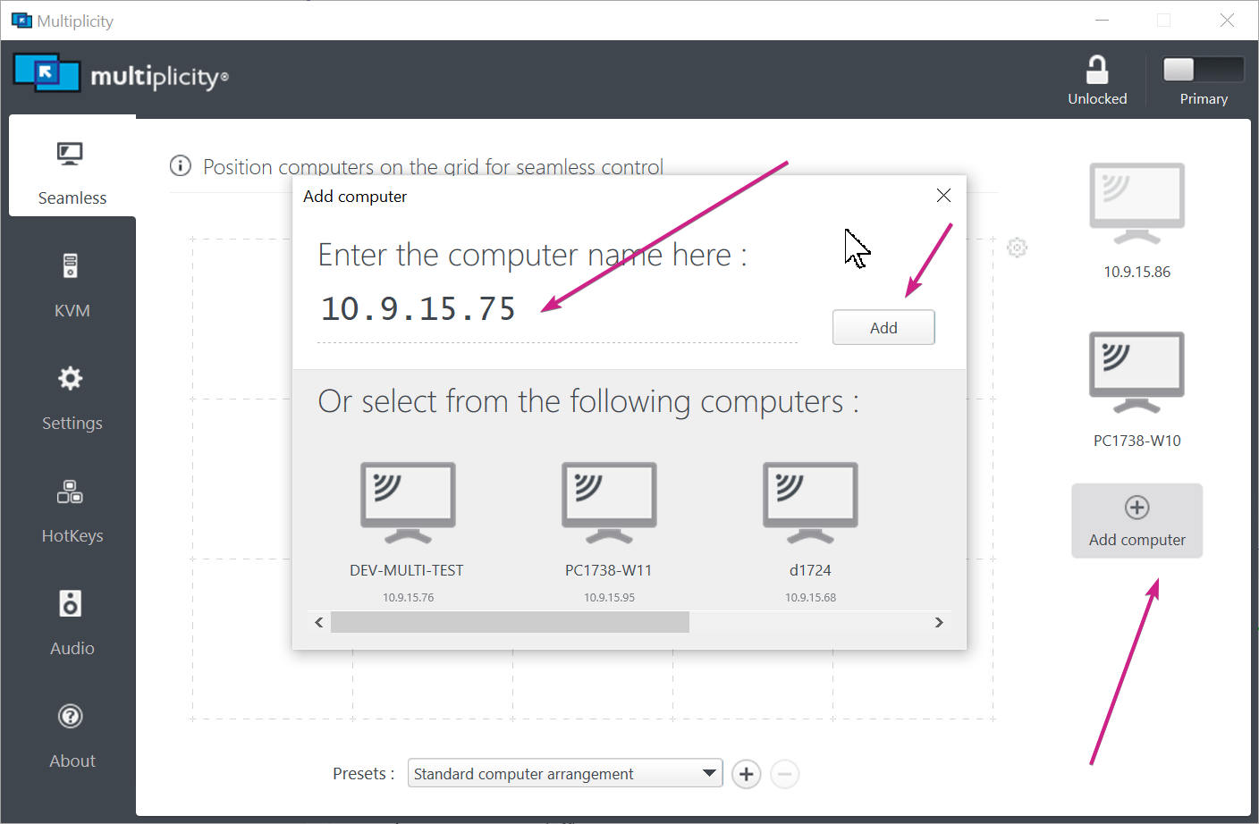

Dont add by hostname, add (it back) via the IP, example:
