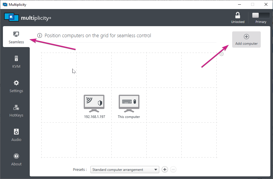

I bought multiplicity ($39.99 version that lets me connect up to 9 pcs) and accidentally selected KVM mode. How do I switch this to seamless? I tried to uninstall and re-install, but KVM was automatically selected.
There is really no 'switching' between the two, you just need to have the PC configured on the Seamless tab:
Note that you cannot use Seamless to a PC that has an active KVM connection.  To use Seamless again, just end the KVM connection.

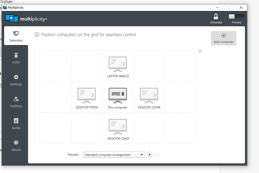

Sorry how do I end the KVM connection? When I hover over the multiplicity icon on my computer's nav bar, it says "KVM mode," but I have also added my computers to the seamless grid:
I don't see anything in the KVM or settings tab that let's me 'turn off' KVM mode?

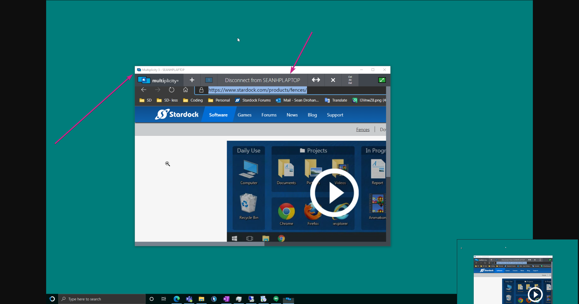

KVM connections would be something you would initiate manually:
And would be clear that a connection window was open. With the KVM session window open, hovering near the title bar will expose an options menu - with a disconnect option.
Once a KVM session to a PC has ended, Seamless connections to that same PC is again allowed.
Sorry but I've never enabled a KVM connection, see my first post, no KVM connection worked. See the image below, I have nothing set up here for KVM
Then I need to know what the core problem is - what cant you do that you want to do?
I can't actually use multiplicity, I want to be able to use the feature that I paid $40 for. My multiplicity still says "KVM mode" but I have no KVM added (see from my screenshot) and none of my other computers have KVM mode enabled... you can see from my first screenshot that I have the computers put on the seamless grid, but it's not working. To be specific, my understanding of what should happen when I am in seamless mode is that I move my mouse to the left, and it hops over to my laptop and I can start controlling my laptop from my mouse. Currently when I move my mouse to the left of my monitor, it's hitting a brick wall :D
