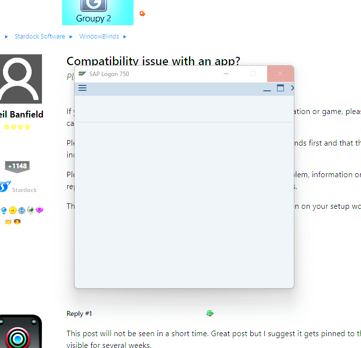

i have strange problem with my SAP when running any of Windows Blinds
End of nathan20's quote

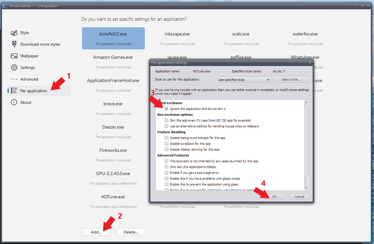

Look like that your SAP is not compatible with Windowblinds. Please set Windowblinds to ignore it so it will not try to skin it. Any application which does not using Standard Windows frame, will having compatible issue with Windowblinds.
Use these steps to add you SAP to Windowblinds ignore list.
It may interest you that version "800" of SAP Logon does not give me this problem (WB doesn't attempt to skin the window at all without me manually blocking it). I don't know if your organisation allows you to update to this release or not but I used the trial download available at their website for testing. The download is labelled as "version 8.10" but this may be a mistake. There may also be an automatic download to this version from the one available (an extra feature of the software) but I have not tested this as this version works fine.
Inconveniently it seems their IT people have included the installer three times in the RAR archive available for download by mistake. I don't know why they did such a thing or even use RAR archives for the general public as there are no installation instructions at all as far as I can see. I would provide the download here to save your time and bandwidth but that probably breaks site rules, sorry.

Sorry to hear you are having issues. Most probably compatibility issue, best to set Windowblinds to ignore it using this setting.
