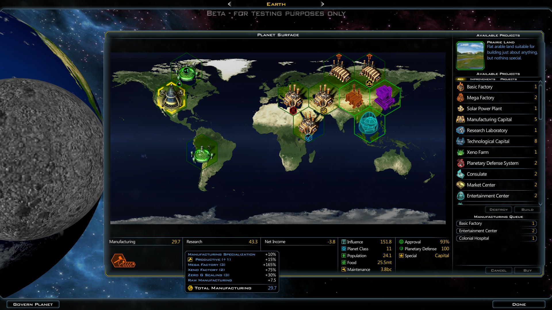

I have verified it. See screenshots: Earth (no production bonuses) and Eagle I Thin Atmosphere (25% bonus). Look at the required turns for the given mp settings.
Planetary traits are applied after the shown mp calculation.
During the game, from where i have taken these screenshots, i have researched building cost reducing techs (-40% for manufacturing improvements, -25% for population improvements). See the difference between the required building turns, even while the (raw) building cost is the same, namely 30.

Earth at 30.2mp
- Basic Factory 1 turn;
- Entertainment Center 1 turn;
- Colonial Hospital 1 turn;
Earth at 29.7mp
- Entertainment Center 2 turns;
Earth at 22.2mp
- Colonial Hospital 2 turns;
Earth at 17.7mp
- Basic Factory 2 turns;
Eagle I at 15mp.
Can even be lower but this is sufficient to demonstrate the difference with Earth (a 0% bonus planet).
Calculated required mp to generate 18 build cost points on Eagle I: 18 / (100% + 25%) = 18 / 1.25 = 14.4 mp;
