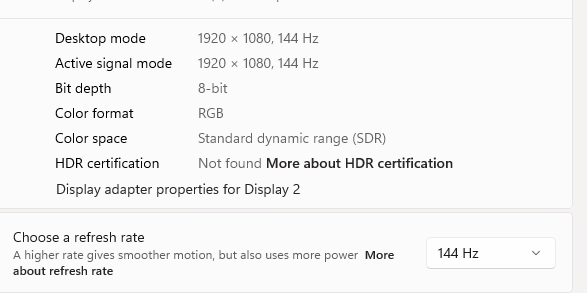

Screen runs same resolution as when it's not running seamless. 1900*1024. I've also tried setting it down. No luck.
If I don't do anything it will eventually disconnect.
The primary computer is showing the screen as screen nr 3. And it's extended.
Just to be clear, this is when you try to initiate a "Seamless Display" connection, you are able to get it to connect but its a black screen, and eventually fails.
